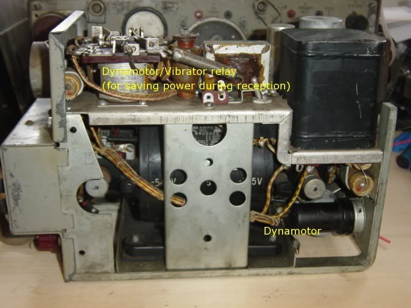

The original military power supply (of which I have one, but not in working condition so far) used a dynamotor and a vibrator/transformer/rectifier to convert 12 resp. 24 DC (e.g. from a vehicle's battery) to the respective voltages.
Normally the vibrator was used while the set was in "receive" mode to save battery power, but the dynamotor jumped in through a relay as soon as the "transmit/receive" relay went into transmit mode.

Here is a picture of the rig I was talking about:
Unfortunately the British Army had the built in VHF set removed in the 1950s, so that it only works as HF CW and AM receiver, and as a CW transmitter (2-8 MHz, 15-18 W)
This is a look on the chassis of another set of the same type, which is more original (hasn't been tampered with)from the top:
On the left are the built in VHF set (in the small shielding box) and the sockets for the tubes of the intercom amplifier, the center is the HF transmission PA amplifier tube and tuning capacitor and the audio amplifier of the HF set and to the right the tubes (and under the big box) the tuning capacitor of the HF set.
http://img.photobucket.com/albums/v174/jkrusat/WS19-top-small.jpg
And this are the spaghetti in the chassis (no printed circuits back then, just phenolic strips with eyelets riveted to them as anchor points for the components):
http://img.photobucket.com/albums/v174/jkrusat/WS19-bottom-small.jpg
Here is the data plate and some details from the front cover. The unit was built in Canada by Northern electrics under a British specification. Sets of this type were also given to the Russians as war aid under the lend-lease treaties, thus the cyrillic lettering beneath the English one:
http://img.photobucket.com/albums/v174/jkrusat/WS19-data-plate-small.jpg
This is a shot of the original military power supply without housing. The dynamotor is in the bottom part. The black box seems to be a transformer for the vibrator circuit. Up on top is the relay, which switches the dynamotor on when the set goes into transmit mode:
http://img.photobucket.com/albums/v174/jkrusat/WS19-PSU-LH-small-text.jpg but the unit needs a full overhaul

actually Tektronics is quite wellknown in professional circles. I got mine surplus from the physics department of the Technische Universitaet Berlin, same as the puls counter on top of the rack (which btw. contains a display full of Nixie tubes) and the pulse generator below the scope.
I just got myself a test signal generator (made by Marconi in the UK, ex British military 1962, 20MHz to 250 MHz carrier plus an adjustable AM modulation signal) off eBay.
Jan

Quoting MD11Engineer (Reply 23):
Tek is good stuff, and even old units like your 545 demand top prices here when they become available-which is rarely. I do not understand scopes at all and I do not own one.
My best piece of equipment is a HP412 VTVM. It uses two clockwork motors and four small light bulbs and photocells for the bridge circuit. It came from Texas Tech surplus, not working.
If you ever get one, all you need to do is open it up, power it up and tunk the clockwork motors until they start turning, then let it run for a couple of days. They get sticky from sitting. The best tool for this is a pencil with a soft rubber eraser on the end.
I also have a couple military VTVMs and three TS352 analog multimeters. They are wonderful equipment of the highest quality and they get sold at ridiculously cheap prices. One TS352 is brand new and one of the others came straight out of military overhaul. None cost over $15.
