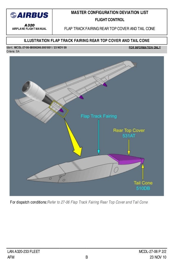

The MEL lists stuff that may be broken or missing (e.g. APU) and any conditions attached. The CDL lists stuff, typically aerodynamic, that may be damaged or missing (e.g. a flap seal), and how it affects the operation, e.g. increased burn.
The MEL is only binding prior to dispatch. Once pushed back, if something breaks and you didn't get a specific ECAM automatically, you'd refer to the QRH (330) or ECAM non-sensed procedures (350). Of course, the MEL might contain important information so it can be useful to have a read.
To use the MEL, either you know the MEL code or not. If you get an ECAM alert, you look that up in "MEL Entries". This will point you to the relevant "MEL Item" (or say "No dispatch"). Alternatively you get the MEL Item code in the dispatch documentation, e.g. if that piece of kit is inop from earlier flights. The MEL Item has a time period (max allowable until repair must be effected) and what the deviation affects (ETOPS, landing performance, etc.). It shows whether there is a maintenance procedure and/or an operational procedure. For example, if the APU is inop the ops procedure would tell you not to use the APU, and then point you to the external engine start procedure. Ops procedures are also in the MEL.
MEL items go from the significant to the trivial. "Eng 1 Manual start pusbutton inoperative" means the button doesn't work, but that button isn't used unless automatic start is inop, so the effect is normally "none". Still needs a little sticker to placard it though. :)
MEL items look like this:
CDL items look like this:
(Pictures are from a Google search.)
