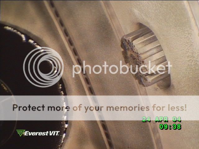

Starting at the front here is a picture of the 10th stage High Pressure Compressor. You can recongnise the vanes and the rotating blades. I had to check the outside brazed joint of the vanes for cracks. The round holes are openings where bleed air is taken out of the engine. The shiny spots on the vanes are not cracks, but some vaseline rubbed off, which I used to lubricate the probe.

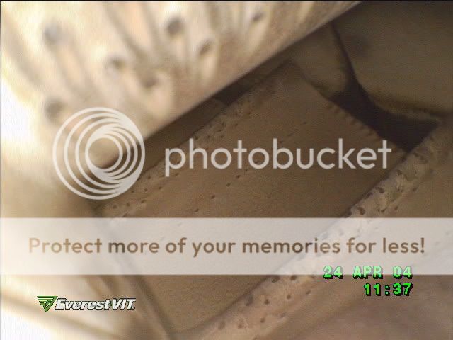

The next one is a shot of the combustion chamber. This engine has an annular combustion chamber made up of loosely interlocked rings (to allow for thermal expansion). At the front end are the round injection nozzles. The nozzles close to the ignitor plugs are a bit soothy, but this is normal. Only part of the air is directly mixed with the fuel to allow a chemicaly combustible mix. Additional air is added through the holes in the combustion chamber liner to cool down the hot gases (the flame is almost 2000°c hot, too much for the turbine, the max EGT on startup, measured behind the last turbine stage is 425°C).

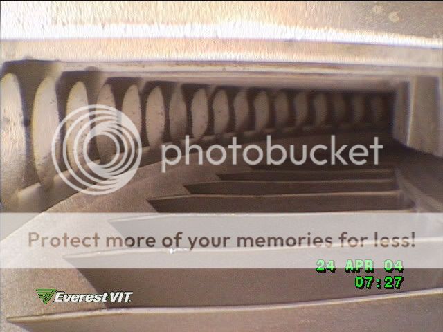

Now we see the rear end of the combustion chamber, where the hot gases enter the nozzle guide vanes to be dircted into the first stage of the High pressure turbine. This is the hottest and most highly stressed area of the engine. The nozzle guide vanes are cooled by "cold" (still around 400°C) bleed air being ducted through their inside. The air escapes through the multitude of small holes drilled into them and forms a protective film arounfd the vane. The vanes look a bit dirty due to residue from the combustion, and in some places the ceramic coating has flaked off a bit, but everything is within limits.

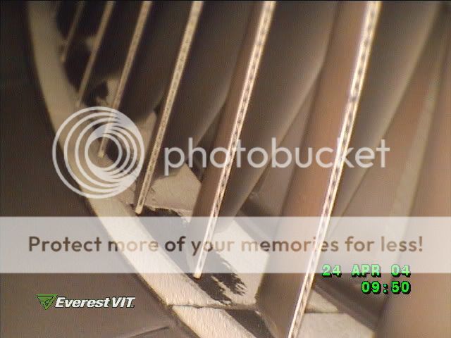

Between the vanes you can see the blades of the first stage HPT, which are not only exposed to an intense heat, but also to high centrigugal forces.
They are cooled in a similar way as the nozzle guide vanes. Here is a better picture of a blade:
Finaly we reach the second stage HPT, where the gases have cooled down quite a bit (they lost energy turning the first stage turbine). Everything is cleaner, but the blades (we look at the trailing edge) are still being cooled internaly (see the slits at the trailing edge). You can se the rub strip on the turbine casing, a soft material, which gets worn in by the turbine blades, so that the gap between the turbine and the casing will be as small as possible for efficiency reasons. The casing is also cooled from the outside with bleed air sprayed on it from a series of pipes with small holes drilled into them to shrink it controlled to keep this gap small, even under thermal expansion.

Things I would look for on a general hot section inspection:
Cracks, burn marks, distorted or molten parts of the combustion chamber liners, which might point to a faulty injetion nozzle (when it doesn´t eject the fuel as a fine spray, to burn immidiately, but as a burning jet, which might strike some part and overheat it, on turbine blades and vanes sulphurisation, blueish or grey discolourisations, which can happen if the fuel contains too much sulphur. It will alloy itself with the metal and make it brittle. Shingled turbine blade shrouds (if the tip shrouds of the blades are not side by side, but overlapping), blade clashing (blades touching some nonmoving part of the engine), FOD, discoloured parts (which could signify an overheating).
There is also an AD out for a continued inspection of the 10th and 11th stage HPC stator vanes one PW2040 engines of certain serial numbers. The stator vanes of thse engines tended to develop cracks in the outer tiptrailing edge region, which caused some engines to "auto shut down" in flight with spectacular results (a vane breaking off and going downstream through the engine). This will continue until this engine goes back to the shop for overhaul and the offending stator segments will be exchanged for modified ones.

I hope you don't mind if I repost Jan's text and add the two pics I managed to get working (hopefully):
"The next one is a shot of the combustion chamber. This engine has an annular combustion chamber made up of loosely interlocked rings (to allow for thermal expansion). At the front end are the round injection nozzles. The nozzles close to the ignitor plugs are a bit soothy, but this is normal. Only part of the air is directly mixed with the fuel to allow a chemicaly combustible mix. Additional air is added through the holes in the combustion chamber liner to cool down the hot gases (the flame is almost 2000°c hot, too much for the turbine, the max EGT on startup, measured behind the last turbine stage is 425°C)."

Regarding the compressor / turbine disks: It seems the high pressure compressor shown above is a single piece; Is that correct? And how many stages have individually removable blades and how many are "solid" (if any)?
I´ve only read about single-part compressors/turbines in context with military engines, so I don´t know about commercial ones...
I guess cost would be the limiting factor (One damaged blade would ruin the entire disk).

It has been quite a while since I worked on PW2037's, but I don't remember any of the compressor disks being one piece. As far as I can remember, all the compressor blades are individual. Some turbine vanes come in pieces of three of four vanes together. Only thing I can think of that is one piece that is interesting is the compressor spool. The rotating disk that the compressor (stages ?? to ??) is made up of several disks, inertia welded together. It looks like a beer keg, sorta.  Smile
Jan,
The ablative material that blades rub away is rubber in the front section of the engine, but I believe in the picture it is ceramic type material. Is that correct? Ceramic ablatives in the tail section?

Concerning the picture of the 10th stage HPC vanes, what you see on the top are the trailing edges of the 10th stage vanes. They come in segments of 5 to 6 vanes. They are also the first non variable vanes of the HPC, all vanes of the HPC forward are variable, e.g. their angle of attack can be changed. On the bottom you see the 11th stage HPC rotor blades. They come single and are dovetailed into the compressor disk.There are 74 blades in the 11th stage. The blade is only 2.050 inches long, the last 17th stage blades are only 1.175 inches long (this is important for estimating the size of possible damage, one of the hardest things when doing boroscope inspections, is it still within limits?).
The turbine blades are also fir tree jointed into the turbine disk. Just for info, the 1st stage HPT blades are 2,32 inches long.
P.S. the rub strip in the turbine is made of some soft ceramic stuff (don´t ask me, all I´ve been doing is boroscopes, I never dismanteled a PW 2040)

Thank you both; In the picture above, the disk/blade joints just happen to be a little out of focus (as they´re probably not the most interesting aspect at this point) so I wasn´t sure.

Klaus,
The boroscope optics have only a very limited field of focus, additionaly the digital camera on this one is always focusing on what is in the centre of the picture. Sometimes it realy annoys me, e.g. if I do an AD inspection of the 5th stage LPT blades for blade clashing (one some engines the 5th stage LPT stator segments moved aft and touched the rotor, one engine quit with a loud bang and a fireball, and the maintenance crew had to pick up a bucket full of turbine blades from the runway...), I use a very old simple 4 mm boroscope without a camera, I just have to peep through the optics.
