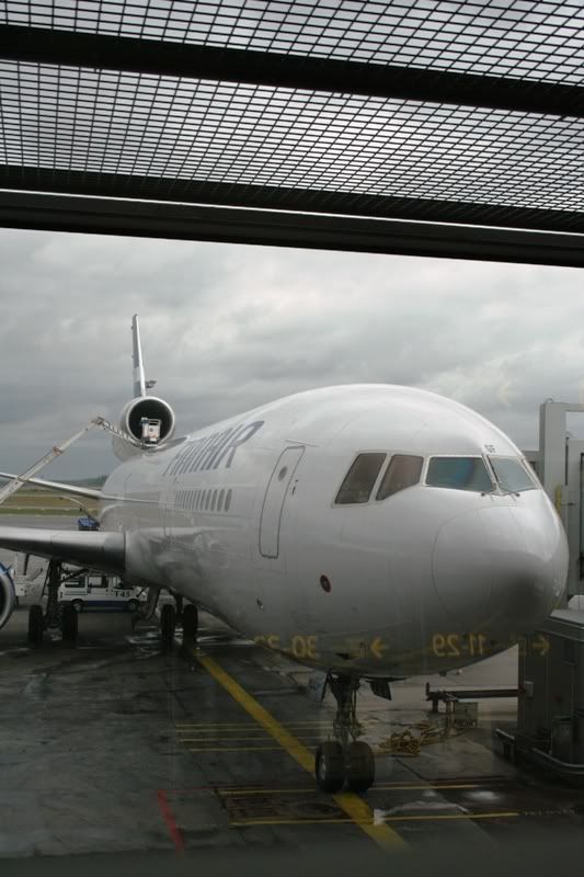

I was walking around HEL the other day waiting for my connection to KUO when I saw this:
http://i96.photobucket.com/albums/l193/OHLHD/IMG_0385.jpg
He then went closer:
http://i96.photobucket.com/albums/l193/OHLHD/IMG_0387.jpg
and then disappeared but I did not see if he went inside the engine.
So my question:
Is it possible to go inside?
[Edited 2008-06-28 04:21:30]

Quoting OHLHD (Thread starter):
Oh yeah it is possible easily and have a nice walk in there. From outside you can see a small area where the engines gets a little smaller in the diameter. That's about where the engine actually starts. There is the fan area and the rest of it is being. I think it's about 5 meters until the fan blades are there.

Is there no access door into the MD11 intake?. On the L1011 we had a small hatch so we could go in there from the engine bay. If you were brave, and had sticky soled shoes, you could then run up the S duct to the intake-

Quoting Tristarsteve (Reply 3):
You can open the engine cowling somehow.

Quoting WILCO737 (Reply 5):
Opening the cowls does not provide access to the fan.
So my question:
What the mechanic is going into is the inlet duct, the engine is located aft of the letter "R" in the first picture. Like I said above the only way to get the the fan blades is through the inlet duct.

Quoting 474218 (Reply 6):
Actually the "R" is on the Fan Cowl covering the Fan/Low Pressure Compressor Module of the engine. The next cowl aft of the "R" is the Reverser Half.
The Tristar needed the door in the S duct because it wasn't too safe to go in from the inlet and worm your way down the incline. Too steep and often a bit too slick. I'm afraid I've left a bit too much skin in too many doing FOD checks over the years.
I definitely prefer the DC/MD inlet inspection for ease and view

Quoting Avioniker (Reply 7):
Maybe if you had a cherry picker.
But on the Tristar you only needed a set of steps, pax steps would do on an outstation. You could open the access panel in the lower left cowl and climb in, then open the S duct access door and climb in there. No need to borrow special equipment.
