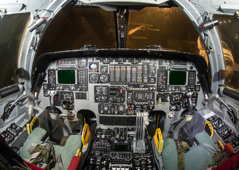

I have a question in relation to the C-17 centrally mounted joysticks.
In most military aircraft with side by side seating and centrally mounted joysticks, both joysticks are moulded for the right hand.
The C-17 is unique in the sense that it mimics Airbus' design of left seat/left hand, right seat/right hand. However, unlike the A-400M which has a side mounted joystick which you can rest your entire lower arm to 'control' (for lack of a better word) your tactile inputs to the joystick, the C-17 design seems to have just replaced the traditional yoke with a joystick, without anywhere to rest your wrist/elbow/lower arm. Any movement would either be too much, or too little.
How difficult is it for a right handed person to fly the C-17 from the left seat? Does it take a while to 'get a feel' of the centrally mounted joystick?

Re: C-17 Globemaster Centrally Mounted Joystick
Posted: Tue Apr 20, 2021 2:04 am
by GalaxyFlyer
I don’t see where it’d be any different that a right-handed person to fly in the left seat with a yoke—both cases you fly with your left hand, throttles with the right. Even in AR, it’s not tough.
Posted: Tue Apr 20, 2021 7:53 am
by flyingturtle
As somebody once said on a.nut, the sidestick (or the central stick) requires less precision than your computer mouse. Every right-handed pilot has flawlessly adapted to use the Airbus sidestick with his left hand.
Posted: Tue Apr 20, 2021 2:56 pm
by GalaxyFlyer
There’s an armrest. I doubt Airbus entered the discussion at all, it’s just taken from fighters as the C-17 was seen a a tactical plane. They wanted to be different.
