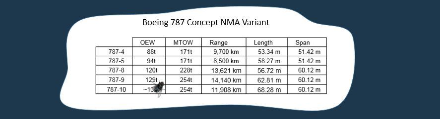

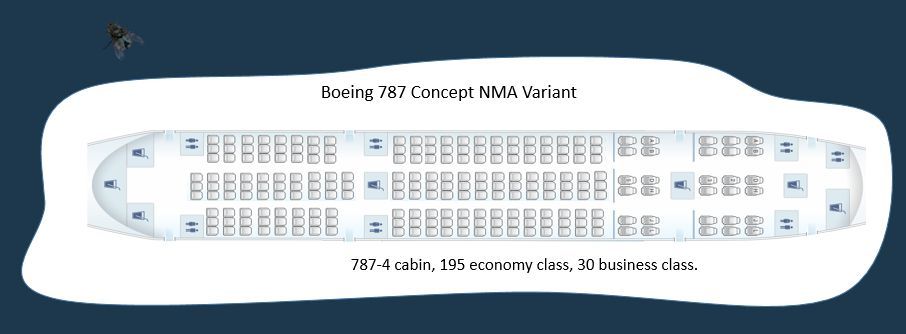

It seems Boeing is looking for a twin aisle MoM solution. Twin aisles are heavy/costly under say 250 seats, so Boeing probably is aiming higher.
If we look at what's in the market, 767, A330 fleets will be up for retirement and 787-8 and A330-8 have been selling poorly lately. Not surprising, these aircraft's weights and dimensions make clear they're long haul machines. Big wings, fuel tanks & landing gears.
Boeing tried for a quick solution with the 787-3, but everybody realized in time that wasn't a good idea. To make to an 787 attractive for short/ medium flights, expensive, radical weight & cost cutting would be required. A 787 MoM would need to fit smaller gates and provide razor sharp CASM at unique payload-ranges.
Advantages of using 787 technology would be lower development costs (e.g. fuselage, engines), fleet commonality and LD3 capability versus smaller aircraft types. Disadvantage could be airlines might find it large for a MoM, despite it being way lighter and cheaper to operate than existing 787 types.

I think it is clear the 787-8 isn't selling anymore. Some say Boeing is avoiding sales of this sub type. Still there are many 767's up for replacement at e.g. DL, AA and UA. On top of that the A330 early fleet from the nineties starts aging.
2000-4000NM flights from ATL
Matching the right capacity requirements might be key to success.

texl1649 wrote:
The 787 is structurally vastly overbuilt for this. Right down to skin thickness. Boeing has always been a very safety first builder and this first foray into composites is no different. If you have to re engineer substantially all of the structure why make it a family member? The gear, engines, wings, etc have to change anyway. That's why the 788 is so heavy relative to a modern a300 type competitor. And Boeing can't wait to stop making them in that size even at a higher price so I think what was learned from the 788 and 783 was just eventually implemented in the 789.
The 788 itself is basically a throw away model at this point for them. That's part of the reason they're working on this new model in any case.
These variants would be 30t lighter and smaller (ICAO Cat D). Only fuselage cross section stays the same. A high capacity short/medium range aircaft. A carbon A300-600 / 767-300 like aircraft.

The 787-8 is a long haul machine. This variant would not "shave off" 30t. It would have a new different wing, wingbox, engines and landing gear. It would have the same empty weight as the 1960s technology, slightly longer all metal A300-600. (which is 30t lighter than the longhaul A330-200).

The 787-8,-9 and -10 share the same center wingbox, wing, fuel capacity, engines and landing gear. Optimized for carrying a full 787-10 on 12 hour flighs. Flying the 787-9 on 8000NM flights.
Remove that longhaul capability out of the 787 and design a new optimized set for the MTOW's given. It's a different machine. The 787-3 just cut off wingtips. That's not comparable. This 787-4 and 787-5 concepts would big MoM's, more on the right upper side of the spectrum.

30 t may sound a lot. But it's difference between a long haul machine and a shorter short/ medium haul machine. Sharing the same fuselage, cockpit, tail but wings, wing boxes and landing gears for different missions.
The empty weight difference between an A330-200 and A310-300 is even more, 41t.. or 34%.
If we are comparing this big 3-3-3 MoM concept to an oval 2-3-2 twin aisle concept with 250 seats single class 4000NM range, that's of course again a totally different beast. We should compare apples to apples, oranges to oranges. :yes:

Exactly. Like the 777-8 is not a 77W shrink, the 737-9 isn't a 737-200 stretch. Or the A330 a A300 stretch.
But they still did it, with a ton of grandfathering, the same production lines and lots of commonality.
This upper sized MoM could in higher density configuration move over 300 people between large cities. E.g. Amsterdam London, 70 flights a day and fit the smaller gates, pay less airport taxes and burn less fuel because it's flying around 30t less structure (~ similar to the payload!) Other use could be found e.g. US Eastcoast, domestic China and the Leisure carriers that use high density, even 8 abreast 767-300ER's and 9 abreast A310s, to the Caribbean and Mediterranee.
