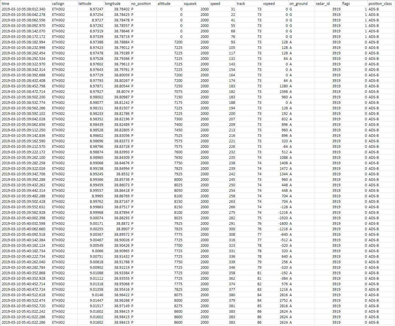

aemoreira1981 wrote:
cschleic wrote:
flyingbird wrote:
It's better to try to understand the data instead of claming that it's bad or impossible.
When on ground the transponder transmitts 0 altitude.
On take off the transponder changes to transmitting AMSL altitude.
And suddelty everything makes sense.
Same thing happens on landing, but other way around. From 7600 feet altitude goes to 0.
Interesting data. But am I reading it correctly.....the altitude goes from 0 to 7,200 (airborne?) when it's at 93 knots? The altitude doesn't show 7,600 ft. until later when the speed is 232 knots, one minute later, after it has had fluctuating vertical speed readings.
Bole Airport is 7625 feet above sea level. Keep that in mind. The land around might be lower.
I know that. But if the transponder begins sending MSL altitude upon takeoff, how does it show 425 feel below the airport as the first reading?

by rbavfan
JoeCanuck wrote:
6 minutes into the flight...would the flaps have been retracted yet? If flaps were extended, MCAS would have been disabled. Playback shows flight ended at an altitude of 8600 ft...quite different from the previous MAX accident.
They are only 1000 ft off the ground at that location. So they were not 8600 ft. above the ground. 1000 ft. above ground could be hard to recover especially in high, hot climate.

by WIederling
MikeAlpha95 wrote:
Please don't mix TAS with GS
Wind at the airport was less than 10knots, easterly.
> HAAB 100600Z 07010KT 9999 FEW025 18/09 Q1029=
> HAAB 100500Z 06008KT 9999 FEW025 16/10 Q1029=

Also note that MCAS only activated when flaps are up. This aircraft didn’t make it far enough into the flight for that to occur.
I also found this picture very interesting
https://twitter.com/satcom_guru/status/ ... 60096?s=21

Looking at these photos it really looks to me the aircraft pancaked/hit the ground at some sort of angle to ground.
Also I’d like to repeat this again, MCAS can only be active in a flaps up condition. This aircraft did not make it far enough into flight for flaps to have already been retracted.

I have heard one crew on radio asking to join the holding east of ADD (AB002) to deal with conttol issues. Aircraft landed safely shortly after me though.
