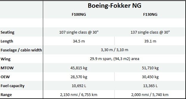

Now I know I will risk my credibility with a lot of people here (if there was any), but sometimes I just like to launch a left field idea, so hear me out.
https://www.ngaircraft.com/
- The lightest and most durable airframe in its class.
- Extremely quite cabin (low power GTF engines mounted in the back), but also very low environmental noise profile.
- The cost of synthetic fuel will in the future require even more optimized airframes. Better not use 3.500Nm planes on 1.000Nm missions.
- London City capable.
- Roomier and less draggy 5-abreast cabin, with more scope to grow than the most direct competition.
- Limited range and thus flexibility, but that just helps to offset it against the A220 with reduced acquisition and operation cost.
- Limited range, also means that future engine developments will increase its range and keep it relevant and economical going forward.
- Extremely low trip and seat-mile costs.
- Rear mounted engines make it more futureproof for future larger diameter propulsion developments (open-rotor/RISE, hybrid). Inline with Boeing synthetic fuel vision.
- Design team, still existing tooling (except wings) and current fleet support organization under one owner.
- High mounted engines help on rough runways.
F130NG compared to the 717:
- Same range.
- ±12 more seats at equal comfort.
- ±3.300 kg lower MTOW.
- ±650 kg lower OEW.
- A smaller variant to aid commonality and share cost base.
Fokker NG compared to the Embraer E2:
- 700 Nm less range.
- ±10 more seats at equal comfort.
- ±10.000kg lower MTOW.
- ±5.000 kg lower OEW.
- 20% lower OEW/seat.
So if it’s so great, why does it not get off the ground?
- It has no (European) political support
- It lacks funding/credibility.
- It lacks manpower to finish the design, production and sales materialization.
Now that’s where Boeing could come in. Their only airframe they have left that will most likely still exist past the current generation is the 787. In the narrowbody segment they are completely out manoeuvred by Airbus and are a few (potential) steps behind the curve.
- Political
Under Biden, a new high profile US-EU economic corporation would be an important symbolic political signal that the EU and the US stand shoulder to shoulder in the changing world order. So that’s the political support.
- Credibility
The Boeing umbrella would provide the necessary credibility.
- Funding
Although funding is never easy, it would be much easier for Boeing. It would almost be small change for them.
- Manpower
Boeing has enough manpower to shift towards such a program to guide it to market.
For Boeing this could be a cheap entry back into the 5-abreast segment, so they can subsequently focus on a 6-abreast replacement. The Fokker NG currently lacks a bit of range to be very flexible. However future open rotor options would move it in the right direction where other designs would become overly capable and perhaps lacks clearance. As said, it's a bit left field, but I reckon it's a nice idea.

Taxi645, I think most agree the F100 is a light, reliable aircraft, that's why it is holding out so long.
But the Fokker supply chain has vaporized, the drawings are on microfilm, the avionics suit was modern 30 years ago.
That makes it a start from scratch, blank sheet/ empty CAD program.
:arrow: A 10yrs, $10B-15B project. And the E2 jets look pretty good meanwhile.

1. Does the Fokker have the avionics for the new engines and predictive maintenance?
2. How far away is this?
3. I believe the E2 sales are suffering on range, how to fix this?
There is a cost to breaking fleet commonality. JetBlue has nice costs (slide 9 of pdf link, if you sum up the numbers) for bringing in a new type: $225 to $315 million for not exactly a large airline.
http://investor.jetblue.com/~/media/Fil ... update.pdf
One reason airlines want more range is fewer subfleets. By specializing in shorter missions, this plane is vulnerable to the new E3, a much more likely partner for Boeing, than longer range aircraft. Part of the reason I harp on range is 2200nm or 2300nm is needed for midwest hubs to Florida.
You ignore the A220, why? Yes, it is heavier, but not all weight is bad:
1. Reduce fuel burn (electrical subsystems weight more, but save fuel).
2. Wing area (if paired with higher cruise, see E2-175 wing extension), as well as helping shortfield performance.
3. Engines. Higher pressure ratio engines are more efficient but require more weight (due to the higher pressure forces). Higher bypass engines reduce fuel burn, but add weight.
Your link notes a Pratt & Whitney GTF sized for a regional jet, in other words the PW1200G, or as noted in your first link PW1x17G.
It has some market potential, but needs funding. The F100NG is vulnerable to the MRJ-1000 relaunch.
There is a chance, but this is 7 years out. I feel the E2 and E3, next gen ATR, A220, and possibly Mitsubishi present tough competition. Would you bet your savings on this project?

As I see it, you're talking about an almost clean-sheet design here. The mold lines of the fuselage stay about the same, but it will need:
1) New wings.
2) Completely new avionics probably including FBW if it's going to be competitive as a new entry, and so with that pretty much every system replaced.
3) Obviously new engines.
So why not just design the aircraft from scratch?
Then, the argument for high-mounted engines really boils down to options to expand engines for future variants. Modern jetliners, even small ones, don't operate out of semi-prepared fields anymore. Otherwise, rear-mounted engines add to structural weight and are less aerodynamically favorable (the "clean wing" is a myth, the engines can act as anti-shock bodies and improve area ruling).
As for a comparison with the 717, a major issue with modern engines is that the tolerances are so tight that the engine has issues with heating/cooling. A major advantage to the 717 for airlines like HA and DL is that it can tolerate very short flights with short turns. An engine with a GTF is probably going to need to take a few minutes of motoring time to come to thermal equilibrium.
I'm just not seeing the business case here.
I've read there has been a digitization effort. At least for the documents, I don't know about the drawings. https://documentmanagementsysteem-info. ... tr_pto=nui I'm not sure what the status is on the avionics.
EDIT: the KM conversion in the table is not correct. Should be 3.880km and 3,700 km respectively.

Serious question, why is the F100NG 500kg over the 100,000 lb weight threshold? That doesn't scream informed system engineering. There are thresholds to be just under in aerospace. Because the USA's standard WW2 runway was built for 100,000 lb, they are everywhere. That seems odd to overlook.
I understand enthusiasm and a desire for jobs. What I don't see is anything beyond a college senior project design study. Sorry to be a cynic, but I am expected to do 3 design studies a day more filled out than this study. Seriously, I'm on a project where we have already changed the configuration 3 times significantly.
I agree with DocLightning, we really do not design for less prepared fields anymore. That is left to used turboprops. Rear mounted engines add weight. The MAX showed new engine configurations are the way forward (yes, also highlighted need for software testing, triple redundancy, and training).

It identified a very clever mounting scheme that is efficient and completely obsolescences tail mounted engines... well for every configuration I worked on that considered a pair of tail mounted engine (business jet, UAV, or passenger plane).
There is no other configuration that integrated the engine up towards the wing as much. I pointed out the lessons learned; no need to repeat them.
The F130NG is trying to promote a design missing several key and proven technologies for reducing fuel burn:
1. Wing mounted underslung engines. Saves weight and reduces cracking as well as so easy for maintenance.
2. CFRP wing
3. Electrical subsystems
4. Predictive maintenance.
Whenever a design constraint can be broken by new tech, in particular the excellent laminar wing/engine/pylon integration of the MAX, I look at how this improves everything. It allows keeping short gear (weight), easy fueling, a low wing (easy maintenance,), and low engine (easy maintenance). Reduces overall aircraft weight and produces less area to deice (reduces fuel burn and reduces structure cracking due to thermal gradients).
What isn't to like?
Breaking design constraints is why I love:
folding wingtips (not really applicable for this size of aircraft though).
CFRP (less weight, in particular in wings and improved durability).
The new aluminums (more for durability and manufacturing)
3D printed titanium (such a game changer in what parts can be economically made from that metal)
electric sub-systems (ok, weight penalty, but such nice fuel and maintenance benefits)
New wingtip options (mission determines optimum)
Very little in the new Fokker NG, it is a very old design. This is not swing #1 at a next generation Fokker. My experience is half the cost savings improvements come from the engine, half the airframe.
Lightsaber

Taxi645
Posts: 532
Joined: Wed Feb 22, 2017 7:29 pm
Re: Fokker NG jet, an unique opportunity for Boeing?
Wed Oct 06, 2021 12:03 pm
I've read that Fokker Services have looked into condition-based maintenance (CBM), but don't know on what parts or airframes, nor am I really knowledgeable on the subject.
lightsaber wrote:
In effect, you are predicting a dramatic increase in fuel costs overcoming the added costs of a subtype. My prior link showed the cost at $215 million to $315 million. What you are proposing is an extreme cost for any aircraft below the so called "Greta line" which... is tough for this size (100 seat miles per gallon).
https://airinsight.com/fuel-burn-stage- ... -a-review/
I don't think this Greta line is realistic, because it is horizontal. Meaning it expects the same CASM from a smaller plane compared to a larger one. Which of course is not how the real world evaluation works where a higher CASM is accepted for the smaller plane because of yield and frequency considerations.
Maintenance costs end up being very important, that will favor the turboprops. I'm trying to figure out a scenario where enough F1xxNGs are sold to justify the project with expected competition.
In general jets thrive on > 1000 nm where the speed advantage over turboprops creates a nice market divide.
In comparison to a turboprop an F1xxNG would have more range, more speed and more capacity. This might or might not be enough for it to succeed.
I wouldn't compare to the 717 as it is a fuel hog at 5,000lb/hr vs 3500 of the A221 on 3 hour missions. There is a reason it didn't sell well.
That's exactly what the F1xxNG would fix, I think it's seat mile cost would be close to 40% lower than the 717. That's game changing.
https://airwaysmag.com/airlines/analysis-airbus-a220-is-killing-it-at-delta/#:~:text=Pilots%20are%20reporting%20that%20the%20A220%20is%20averaging,the%20mainline%20operations.%20A%2076-seat%20aircraft%20will%20
Today jetfuel is at $2.05/gallon or
$ 0.302 per pound or $665.6 per metric ton. The A221 burns 1.588 metric tons per hour per above link or $1,056.7. Let us pretend fuel goes to $2,205 per metric ton, about the highest aviation could support, in my opinion. The per year fuel costs of the A221, for 8 hours a day utilization, go from today's $3.09 to $10.22. So theoretically, a subfleet of 20+ could be justified.
But that ignores A220 or E2 improvements, new turboprops, and the Mitsubishi Spacejet. (The much higher fuel burn of the 717 need not apply). It requires that high fuel cost to be a reality. e.g., I worked on the Pratt GTFs in the late 1990s, EIS took a massive spike of 2010-2014 to justify the investment.
https://inflationdata.com/articles/infl ... %20rows%20
I'm afraid the time synthetic or other low carbon fuels push prices high enough, we'll be ready to replace all the current aircraft.
Lightsaber

Of course you are right. However you can also look at it in another way. If I just focus on the weight bit, the F1xxNG proposal is already so much lighter (also because it gives up range of course) than the competition even without most of these improvements. Everything staying the same, lower weight means lower fuel burn regardless of where it comes from. The fact that it is so light without these improvements effectively means that the potential for future improvements is only even larger.
On the wing, I'm not sure what they have in mind on the wing except for it being aluminium. Will it have a higher percentage laminar flow? Who is going to produce them? I do know the Netherlands has excellent institutions regarding aerodynamics. About not being CFRP, is it not so that because the range is limited, induced drag during cruise is smaller percentage of the the total drag over the duration of the flight. With induced drag being less important, a smaller span is can be an acceptable trade-off (It has a 29,9m span for a fairly limited weight. With a smaller span the weight gains from CFRP are more limited as well.
1) New wings.
Well mostly I would say that there is already a support structure for the current model, the tooling is still there (except apparently for the wings) and a lot of work was already done on it. Also would something from scratch have much better economics? The specs do look quite good if true.

lightsaber wrote:
The Greta line isn't CASM, it is fuel per passenger mile. CASM is still higher for smaller jets (e.g., still two pilots, you still have one person fueling the plane or driving up the baggage belt cart). Either it is regulated, which would be the Gretta line, or it is fuel cost which might be too much.
Yes, but fuel per passenger mile also increases the smaller the plane is. A fuel per passenger mile regulation which would apply equally to large and small planes would meet an enormous resistance from the industry one would think.
lightsaber wrote:
I'm trying to find the business case you are identifying. I've done aircraft trade studies. When an aircraft has a niche, it "pops out" as the ideal candidate. e.g., some aircraft are more efficient in climb (LEAP-1B) others in cruise (LEAP-1A) and that helps determine what aircraft airlines buy.
Lightsaber
Well, in the past at a certain point the original F100, despite the light airframe, was not that economical any more because it had old Tay engine. Furthermore it lacked range. Leapfrogging to a PW GTF, would tackle both issues simultaneously. I'm not sure if there's a business case. I do think that in a synthetic fuel aviation environment, the fuel burn numbers compared to the competition in the graph on the site linked in the OP look very interesting.

Taxi645
Posts: 532
Wed Oct 06, 2021 3:33 pm
jeffrey0032j wrote:
Even if they wanted a T tailed 5 abreast plane, Boeing wouldn't need to look at Fokker as they have the drawings for the DC9 family all the way to the 717. They even have 2 MD90s which they bought from Delta for some unknown purposes.
IADCA wrote:
OP: While an interesting idea, a major issue is - as others have noted - Boeing already has the drawings and testing data for the DC-9 through 717 series. If they're looking to make a tail-mounted NG 5-abreast airplane off an existing design, that'd be less costly and likely just as effective as the Fokkers. Plus, you're comparing a hypothetical F1XX NG to the existing 717, not to an NGed version of that. There would be less to do to get to an equivalent point on a 717 to make a current-generation flyable airplane and I'm not intuitively seeing why you couldn't make the same changes you note - for example, lengthening the fuselage back into the MD-8X range to trade range for capacity, as that seems to be your desire. Further, there would be less to do in terms of changes to accommodate avionics upgrades and the larger engines on new generation planes.
If they wanted the plane you are talking about, it'd be a lot easier for them to just "NG" the 717 - which, tellingly, they weren't interested in doing before, instead killing it off in favor of their own (in many ways inferior) product. And that's the second issue: Boeing has no history of acquiring and maintaining designs nor, at least right now, the corporate culture or will to do anything but the laziest and most expedient solution. They certainly don't seem to have the ability or will to put out new models or evolutions of old ones without significant issues right now and would be better served correcting their existing issues than wading into a more complex version of the same mess they're in twice over now with the 737 and 777.
This F1xxNG proposal already has a 5.900 kg NG weight increase built in, if you NG the 717 the weight difference between the F1xxNG and the 717 would again become much bigger. Furthermore the 717 already has much newer engines than the F100 had, (in fact an early Fokker revival design even had the 717 engine family as propulsion).

Lightsaber
Sure there is some explenation for the weight difference, but still can not understand why it is this big :
Difference in OEW per seat in % more than Fokker 130 (# seats in type specification)
A320 neo (161)
46.7%
A220-100 (110)
70.7%
A220-300 (135)
46.4%
B737 MAX8 (158)
52.1%
E190 E2 (106)
66%
E195 E2 (132)
44.4%
They are now proposing an aircraft with basically the same engine as the E175-E2 caring 137 passengers over the same range. That is 71 % more passengers. If they really could pull this off, it would be highly efficient machine. I think they simply do not have the support to do so. Boeing has and that is what this thread was all about. Unfortunately, still not likely to happen.
A320 neo (161)
46.7%
A220-100 (110)
70.7%
A220-300 (135)
46.4%
B737 MAX8 (158)
52.1%
E190 E2 (106)
66%
E195 E2 (132)
44.4%
The issue is I think all the competition seat counts are low. Without knowing the assumed Fokker pitch, I believe every competitor was shorted rows of seats. Also, why only compare on OEW weight? Fuel burn us the metric.
I'm also skeptical on the released empty weights for the NG.

I design aerospace systems customers like. For example we had to go to the customer on the latest to increase cost by a few million per unit and weight by a huge amount to meet their maintenance time on station requirements. They screamed, but then came back realizing we were the only ones offering a truly low maintenance solution (five and a half years between C checks in high utilization duty in a harsh environment).
The fly sheet weight is good. But that doesn't mean that is the offered weight.
Also, shorthaul is tough. We're discussing in another thread 50-seat replacement with buses and all electric 19-seat turboprops. I would, for example expect LCY to lose a lot of traffic to the next high speed rail improvement. Wouldn't you?
viewtopic.php?f=3&t=1465609
If you find more details, please let me know. Empty weights help sell, but until I know more about subsystems, it is hard to evaluate.

Thanks a lot for that Lightsaber. Really nice, much appreciated
3 Things.
1 The Spey engine is on the original F28. The F100 had the Tay engine on it. I think that reduces the weight increase.
2 Wing area. The F1xxNG has new wing ends which extend the wing span from 28.1m to 29.9m (30.6m effective for the winglets seems about right). For the wing area I estimated a growth from 93.5m2 to 94.3m2.
3 Parasitic drag. How did it enter the equation? On the F1xxNG all surfaces are smaller;
- Fuselage
- Wing
- Nacelles
- Control surfaces
3 Things.
- Fuselage
- Wing
- Nacelles
- Control surfaces
Thank for the correction on the engine, that means I pulled the wrong weight.
Since the major drag is fighting gravity in a climb (weight) or altitude for win loading, I ignored parasitic drag differeces, which would favor the F NG. However, there is a "take back" with wing mounted engines. I neglected the asymmetrical inlet profile on tail mounted engines that is a fuel burn penalty (due to aircraft boundary layer), this should be a wash between A220 parasitic drag and the Fokker. This would slightly benefit the E2 numbers, but shouldn't change the NG vs. A220.
I also neglected the cg benefits of modern avionics to balance the aircraft. However, I'm not aware of these systems in the A220 or E2 either. Why? I've seen in smaller aircraft... Perhaps reliability risk wasn't worth it? (The smaller aircraft I've seen it in were longer range where tuning weight/balance has more benefits).
Lightsaber

Ok Tay is 1598kg
https://www.easa.europa.eu/sites/defaul ... e%2005.pdf
That gives 2092kg for the larger nacelles, avionics, and such. Ok, more plausible.
Other numbers shouldn't change, except I should discount the E2 fuel burn a little.
