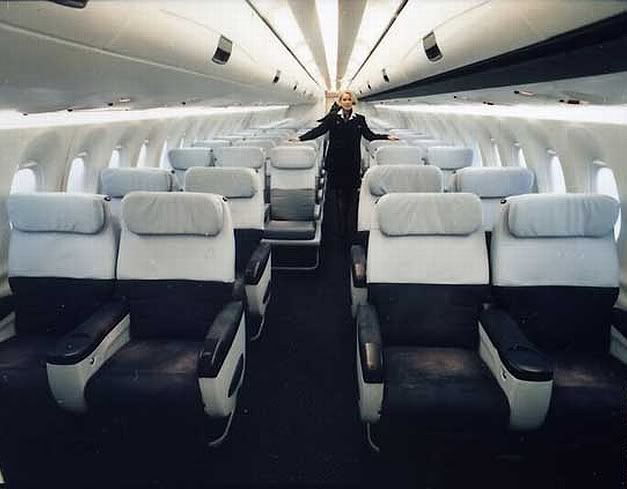

Cabin Comfort
The wide cabin is dimensioned for a comfortable 2-3 + 2-2 lay-out with every seat having two individual armrest. On top of this the aisle is 30inch wide, allowing passengers to pass each other / cabin staff with trolleys. A first are the small roof top windows that spreads a friendly natural light in the cabin, giving every passenger a perception of space. Large windows and luggage bins further enhance passenger comfort.

Quoting Keesje (Thread starter):
Hehe. I will remind you all that the 380 was supposed to have a spa, a store, a swimming pool, a bowling alley and a go-kart track.

What are the black rectangles on top of the fuselage? Ejection seat hatches?  Wink

1. Seat range does not fit in with E-jets, a design with Embraer involved would probably have a seating range starting at 120 to 130 seats (@32").
2. Range is too short. A 150 seater needs to be able to do transcon flights (or have an extended range version with the capability).
3. Cruise speed is too slow. There is zero chance of an airliner that cruises slower than M.75 being made. Interoperability with older aircraft would be crazy from a scheduling point of view and flying more than 10% slower than the rest of the traffic would be very bad from an operational perspective.
4. 2-3 layout does not make sense if the airframe is to fit into both Embraer and Boeing's portfolios. A single airframe to cover the ~130 to ~250 seat range has to be 3-3.

Quoting CygnusChicago (Reply 9):
As noted in the thread starting post:
Now remove the 4 extra armrests winning 8 inch and bring back the aisle to 20inch and we have a couzy 6 abreast cabin for low cost short flights.. hello Ryanair..
