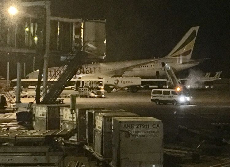

Apparently a ET B788's nose gear collapsed at the gate in ADD
http://pbs.twimg.com/media/Ccuhr2XWwAAvSQr.jpg:large
http://avherald.com/h?article=494e63...rce=twitterfeed&utm_medium=twitter

Quoting litz (Reply 5):
Other than the repair from the burned out ELT, is this going to (possibly) be be first large-scale skin repair?
It depends on if a tow bar was hooked up and what was underneath the nose. When airplane skin and vehicles or other steel objects get in fights, the airplane never wins.

Since I don't know..... and I realize there is no report out yet on this case ...
If the gear indicates 3 green and locked why did this happen?
Also I have seen that the pilot checks if a pin has been removed and on the AVHerald someone said there was 2 pins?
Just trying to understand why gear collapsed when there locked in place when there down, they don't collapse when landing so why when pushed on they can or do.

Question: Would the large engines contact the ground in such an event?
If God had wanted men to fly he would have given them more money...

Have they said for certain that the forward fuselage made contact with the ground?
I looked at one of my 788 models over the weekend, and it appears the plane
would come to rest on it's engine casings?

Quoting Sooner787 (Reply 37):
I'm no expert, but I'd guess that the engines would be crushed/bent so that the nose does indeed contact the ground. You model wouldn't show that...

Quoting 777X (Reply 38):
I looked at the photo again and it looks like the engine are bent up slightly,
so it may have damaged the engine casings as well as impacted the
underside of the nose(fuselage).
Looks like an expensive repair job
