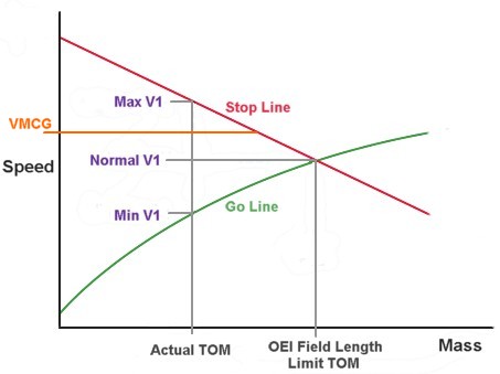

Actually not quite. Unless you're at the absolute limit, V speeds, or at least V1, can vary depending on bias in the software, which can be more "go" biased or more "stop" biased.
Take a look at this graph. Unless you're at the intersection of the stop and go lines, the V1 speed can be anywhere between them.
Re: Rotation Speeds....
Posted: Mon Jun 18, 2018 2:21 pm
by slcguy
Yes Starlion, that is correct. As I said in my first post V1 may vary due to runway length. Basically the speed that you can stop if you abort or fly if you continue, where the stop and go lines cross is the normal V1. Aircraft weight. and braking power are factored in. Magman's original post is more concerned with VR.
Indeed.
