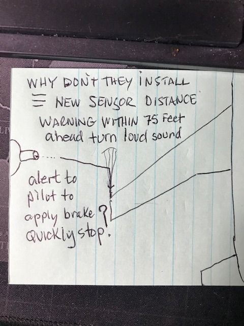

Posted: Sat Feb 16, 2019 3:06 pm
by Q
Why don't they get a new sensor for the pilot to alert sound to apply brake quickly to stop?
The sensor should be warning sound within 75 feet ahead of an object to make a sound warning in the cockpit so the pilot can apply a brake to stop plane avoid collision wing with any object or aircraft's wing or tail etc.
Would that be a good idea? :yes: Save a million of dollars to repair and waste of time plane not in service for a few weeks to repair. :banghead:
Q
Re: More and more wing clipping incidents?
Posted: Sat Feb 16, 2019 5:46 pm
by 747Whale
There is no need to modify aircraft with sensors, the equivalent of car whiskers or curb feelers, if the aircraft is operated properly. Before we ever leave the gate to taxi, we've already reviewed the routing so that we know whether the distances permit our aircraft, and we've included it in our taxi briefing. If there are restrictions, we've considered them, and know where we'll have to turn or what taxiways to avoid. It's published.
We have references throughout the cockpit so that we can look through the forward window and side windows and know that this particular corner of the window represents the ground track of the left main landing gear, for example, and that corner represents the wing track. I can quite literally look at those references and know exactly how far my winglets will be and where they're tracking even though I can't see them fro the cockpit.
When maneuvering close to other aircraft, on a crowded ramp, for example, centerlines are followed, and taxiing is done slowly, and when proximity is close, the aircraft is tugged and wing walkers are used.
Posted: Sun Feb 17, 2019 12:34 am
by AirKevin
And if there's something behind you, as in the case of a pushback? I don't know that the pilots can hit the brakes without risking damage to the plane or the tug during pushback.
Posted: Sun Feb 17, 2019 2:45 am
by kalvado
AirKevin wrote:
How difficult is it to relay a warning to pushback crew? I don't see that as mission impossible.
The only question is if these wingtip accidents are common enough to warrant sensor certification and extra weight.
Specifically for 777x, where inspection - and possibly damage - of wingfold mechanism would make such accidents more expensive?
Posted: Sun Feb 17, 2019 7:59 am
by AirKevin
kalvado wrote:
AirKevin wrote:
A sensor that warns you of something ahead of you would do nothing for something behind you. Even then, I am guessing in the time it took to relay the warning to the pushback crew, you would have already hit whatever you were going to hit.
Posted: Sun Feb 17, 2019 12:54 pm
by kalvado
AirKevin wrote:
kalvado wrote:
Ok, so we need a total of 8 sensors: 2 forward looking and 2 rear looking on wingtip, 3 rear looking on horizontal and vertical stabilizer tips, and 1 on radome because pilots trnd to be too reliant on automation. Sensitivity cones and distanced may be discussed.
Warning devices: sledgehammers on overhead panel in cockpit for forward movement; red indicator and buzzer next to taxiing light. Red light is illuminated if unsafe to taxi: something in sensor range, parking brake set, steering bypass not enabled, maybe some other conditions. Buzzer activated when proximity sensor activated and inhibited by parking brakes to avoid warnings when not taxiing. Buzzer also fed into the ground intercom headphones.
Somehow we are taking about a fairly complex system, and a fairly simple logic is nothing new for another warning subsystem.

kalvado wrote:
AirKevin wrote:
All of which would need to be certified. How much would all of it cost, and would the airlines be willing to pay for it.
