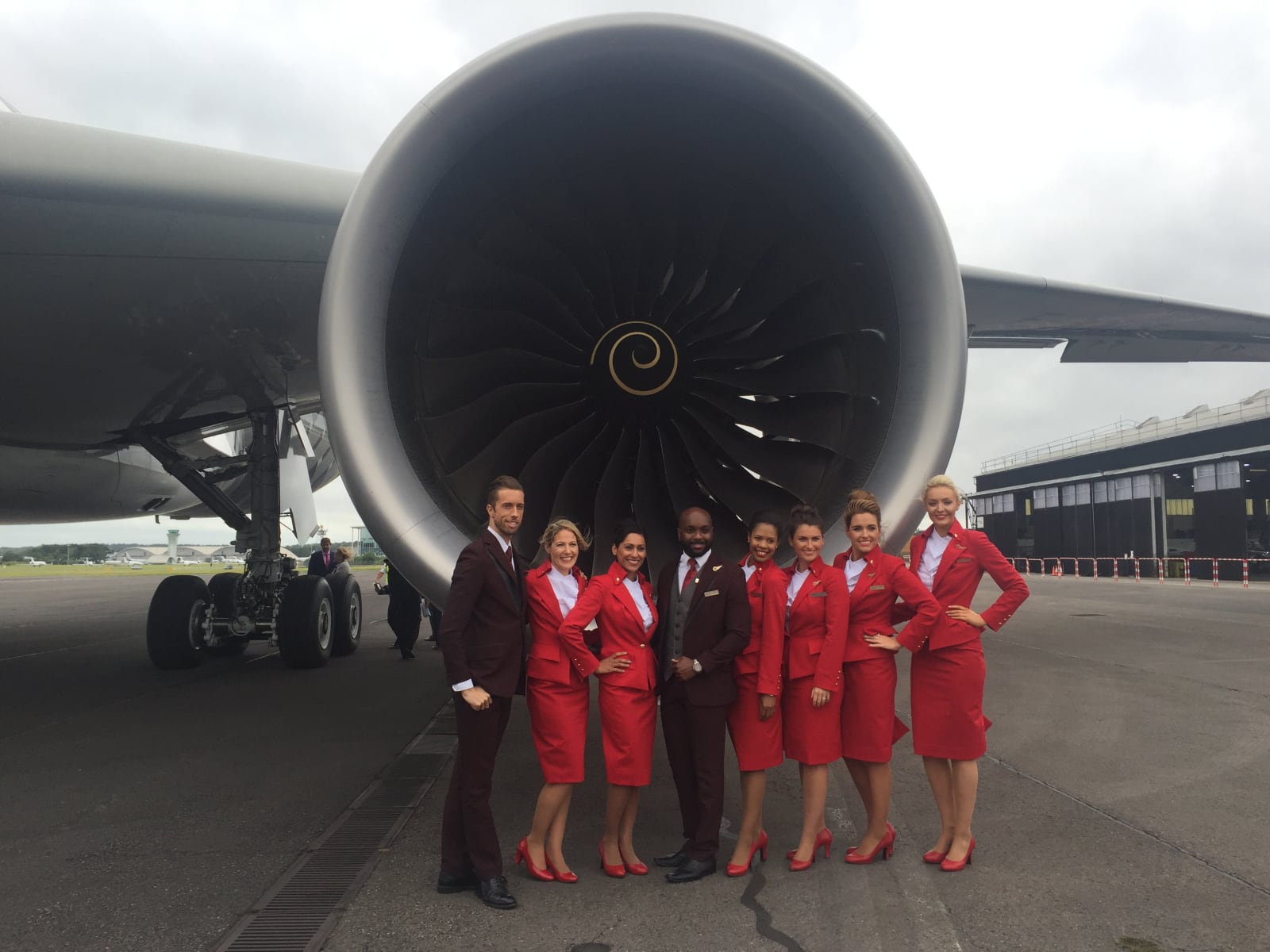

by Vladex
Armadillo1 wrote:
all modern liners except A380 have about the same engine clearance, so A350 or 787, but they will face MAX issue in future.
787 is the 737 of wide bodies in terms of ground clearance. It hugs the ground like a turtle. It's interesting how B handicapped their two most selling jets like that but have the longest landing gear on late 757 and 777.

Where do you see a gap for a bigger engine on this 787 where they sag down to a man's knees ? Those numbers seem off .
A350 seems somewhat higher , by people midsection

Exactly!
BTW that last pic seemed a bit weird to me because VS doesn't operate the -900. Then I saw it was one of the Airbus livery planes...

It's hard to find A350 engine pics with people in front so I picked it from an engine order page of A350
https://www.virgin.com/news/virgin-atla ... s-350-1000

No problem. Just noticed the weirdness. :)
I can by the way confirm that the A350 cowling is rather far off the ground compared to the 787. Waist level is about right.
