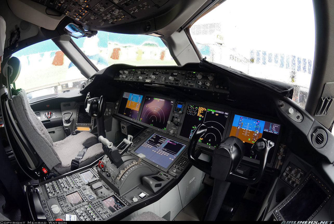

Comparison of the upward winscreen visibility of a 787 vs an L-1011:
Why the big pinch in the centre of the upward field of view in the 787? I frankly don't see how this is within regulatory minima...

If you look at it from more or less the pilot's viewpoint you can see that visibility is fine. You're not sitting right behind the central pillar. I think the L-1011 pilots were also sitting farther from the windshield, which would give them a smaller field of view.
Of course it is within regulation limits. Otherwise it wouldn't have been certified...

What regulatory minima have been infringed? Do you have something specific that you think violates regulations on the 787 windscreen?
With all of Boeing's woes, I think it's one thing they got right, and I haven't heard any complaints about visibility on any Boeing airplane. If you're sitting up next to the glass there's plenty of view - you wouldn't fly the plane from the position that the photo was taken.

I think the lens used in the 787 photo also distort the comparison

I don't actually think this is not within regulatory minima...what I mean is I would like to see that graphic of the 787 visibility from the left seat point-of-view versus the regulatory minima...it would be interesting to see whether the 787 visibility sits just within the upward cockpit visibility margin...
The effect may also be due to the lens used as zeke wrote...and I guess that --as in so many domains-- the Tristar was also in a league of its own when it comes to cockpit visibility too...

What I think you're seeing there is that the 787 actually has *more* visibility to the sides of those front windows. If you were to actually measure that central pillar, I'll bet it's within an inch of the L1011. That photo is definitely giving you a trick of perspective due to the wider angle lens used in the 787.
If you were to chop the 787 windows from the top of that central pillar straight across horizontally, and shot that photo with the same lens as the L1011, I doubt this topic would even exist.
Precisely !
Those windows are huge compared to previous generation acfts. You could take the lowest point of this "pinch", extend it horizontally on both sides, and you would still have better visibility than on the 737 for exemple...
