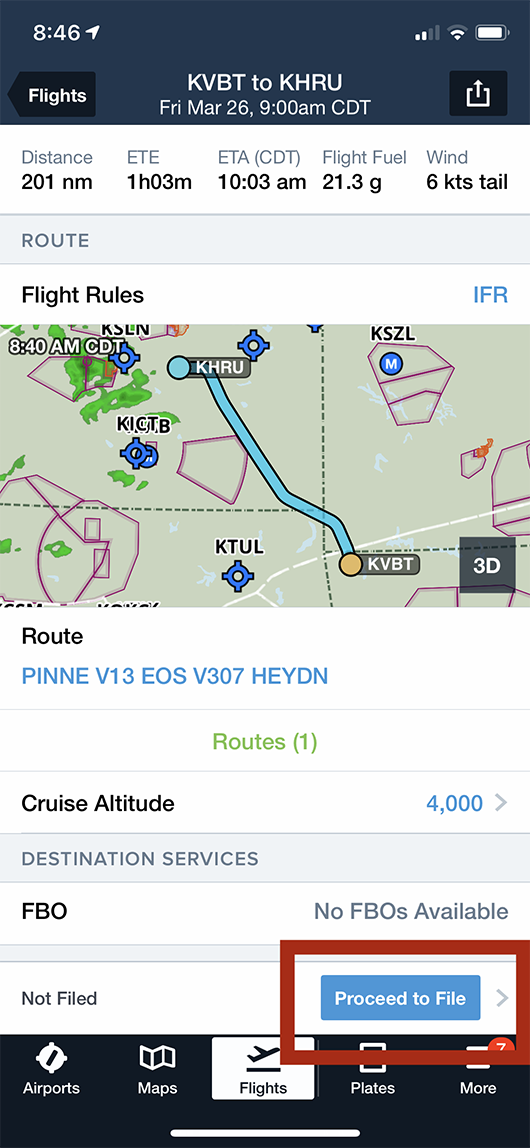

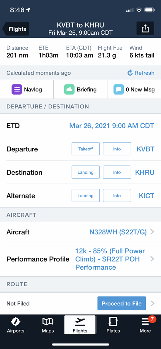

To give you a sense of what it looks like for us lowly General Aviation pilots, this is how we file a flight plan using ForeFlight. All we do is click the Proceed to File button on our flight plan and in a relatively short time (10 minutes usually) it is filed with the FAA and even visible on flights like FlightAware.
