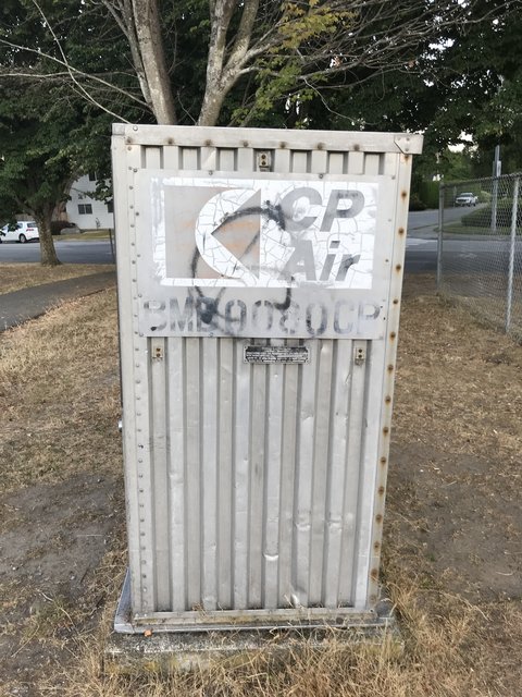

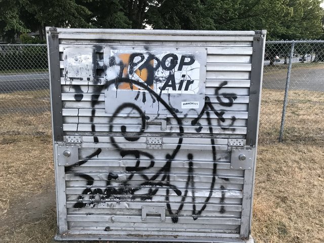

Saw this yesterday, cemented down in a school playground of all places. Anyone have an idea what it may have been used for? I'm thinking for luggage or something but I've never seen a container like this one before.

The identification on the first side leads me to believe it's a container of some sort. Not sure what a BMB container is, though.

Interesting! I thought BMB's were pallets?

The M in BMB, in current ULD standards, implies a base plate dimension of 96x125 inch. It's hard to tell if it's that big from the pictures.
Maybe its a custom container only used by CP Air?

Its a good 5 feet tall, 4 feet wide and 3 feet deep (rough estimates).
Whats so bizarre about it is that its just randomly sitting in a school playground at Pebble Hill Elementary in Tsawwassen BC. Theres another plate on it (the black one in the first picture) and says something about "burn rate". Not sure if that has anything to do with what it originally was or what its being used for today, which I also have no clue about.
I will admit, I was pretty tempted in thinking about prying the CP Air signs off :lol:

Burn rate is a standard thing to have on the side of a ULD.
This thing has me stumped. The base is definitely a loadable pallet. But I’ve never heard of a BMB, and following the standard IATA ULD conventions for coding, this thing doesn’t follow any of them.
My best guess is this was some sort of custom container, probably used as a flight kit. Basically a tool box ULD that mostly stays with aircraft that frequently travel to outstations that might not have full maintenance readily available. (usually has spare bulbs, manuals, tools, etc)

It reminds me of the containers that the RAF used on their Tristars.
They were loaded through the L2 pax door and ran on a track in the fwd cabin.

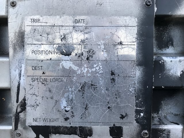

I went by it yesterday again and took a picture of the other placard, quite a bit more info on that, not sure why I didn't take a picture of it the first time.
So, looks like the manufacturer was Brooks and Perkins out of Michigan and the unit was built January 1974.

Its a main deck luggage container with sliding door, its sized to fit though the passenger door.

What I posted was accurate, this is the old B&P brochure for the container.
Some more background https://www.uldcare.com/wp-content/uplo ... tments.pdf
“ Creating Combi models of today's mainstream aircraft such as B777, B787 and A350 XWB would clearly take enormous amount of time and money, and also be non- reversible, but there are actually a couple of ”combi lite” options that may be well worth considering, being low cost and avoiding complex and expensive aircraft modifications while enabling the use of container type loading reduce manpower and turnaround times.
Method A.
1. Back in the 1970’s/80’s a number of B747 /DC10 operators utilised a system whereby a lightweight non powered cargo loading/restraint system could be laid onto the floor of the rearmost compartment of the aircraft and secured to the seat tracks. The system was removable ( maybe half a day to remove or install) and enabled the use of special cargo containers that were typically having dimension of 38 ins wide ( to fit through the pax door ) by 64” high by either 61.5 or 125” long. There was no significant modification to the airframe.
2. A number of airlines used these systems, Alitalia and Philippine Airlines, Lufthansa and Aer Lingus are four ( also KL used on DC 10‘s), and they were manufactured by Transequip ( now owned by Telair) and Brooks and Perkins
3. Certification was by STC, a search under the FAA’s STC library at
https://rgl.faa.gov/Regulatory_and_Guid ... inFrame?Op enFrameSet throws up a number of possible hits, most specifically SA3740WE and SA 2801WE .Although these are of course for 747-100 and -200 aircraft the principles would be the same.
4. The containers had a max gross weight of about 800 lbs, presumably to be capable of handling a 9G load as there was no 9G barrier net, and had to be loaded with doors facing aft.
5. The containers were loaded using either a a main deck loader or a modified catering truck and the cargo loading system
provided a ball mat right up the door sill, so the containers could be easily moved into position.
6. There was some kind of aisle allowing passenger access to the rear toilets and lightweight vertical panels to close off the cargo holding area.
This is a proven concept, used by a number of airlines years ago but long since forgotten however it would seem very feasible to dust off this concept, adapt it to today’s aircraft and put it into service within a realistic time and cost.”
