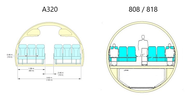

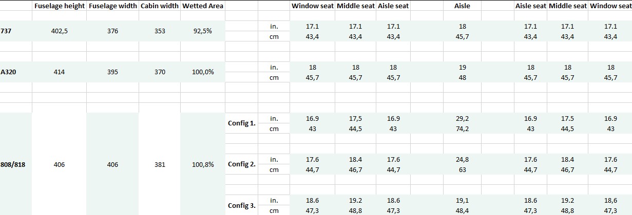

Here's my concept of a shared 6-abreast fuselage for the Boeing NSA and NMA:
It uses the circular dimension of the MC-21 fuselage, but with a lower floor to provide an even roomier cabin and most importantly, more width at the limiting head and shoulder height. This will require a new container type. Boeing being one half of the duopoly might be able to push that through. If not, bags it is. It would not be the end of the world, the comfort and flexibility from the extra cabin width that allows a passing aisle is more important in my view.
This fuselage design with the lowered floor will, within the same wetted area of the A320 series, have an aisle wide enough (with 737 wide seats) to pass each other for very fast boarding. In the NMA configuration it would have seat width and a spacious cabin a 321XLR could only dream of.
Personally I think this fuselage concept would be the ticket for Boeing to make a strong come back in the single aisle market. A come back Airbus would struggle to have an answer to. Boeing would have a plane that:
- Shared NMA/NSA cross section.
- Is 28 cm / 13 cm wider than the 757/737 and A320 respectively at comparable wetted area of the latter.
- Flexibility in seat width vs aisle width. (both short haul boarding speed and medium haul seat width comfort possible).
- Very comfortable economy possible vs. only 737 width possible on the small double aisle proposal).
- No floor in compression
- Much more cargo space than on the small double aisle proposal.
- You can than have a plane that has a fuselage advantage the A320 can not match without going cleansheet
- After ramp up will heave a production efficiency advantage.
- Will have state of the human/machine interface from lessons learned from MCAS.
- Have solved your MAX replacement problem, successfully launch a new 3x3 against a 60+/month competitor and cater fore a very decent part of the middle of the market with the NMA version of it.

On container / pallet options, the A320, C919 and MS21 have it. AKH is the defacto standard in Europe and Asia. Asian airlines warned Boeing not having it on an NMA, is a no go for them. I think it is highly likely it will be an option on any new Boeing NSA/NMA. It's always been an burden on the 737, exploited by Airbus.
If you want a passing aisle/high comfort NMA option within the A320 wetted area there is no other option than lowering the floor. Anyone who doesn't want the new lower container standard can use bags. My estimate is that the attractiveness of a shared fuselage between a passing aisle NSA/ high comfort NMA within the A320 wetted area would more than offset the disadvantage that some regions will be very reluctant to accept either the new container standard or bags option. I think, long term, you could still get about 50% of the Airbus/Boeing market share and good way to differentiate from just being a slightly newer A320. Something Airbus could do themselves much easier, quicker and cheaper than Boeing. Of course it hard to say for sure from my position what airliners would decide when they have to draw their wallets.
If you want to go to the same passing aisle/comfort levels with the standard container you would indeed need to go up to a ~4.15m fuselage with the accompanying drag and weight. That would make it hard for the NSA to be competitive especially within the 36m wingspan limitation and for the smallest variant. If you can't share the same fuselage cross section between NSA/NMA, you loose economy of scale and flexibility at final assembly, which would make it very hard to gain back market share with a clean sheet against the A320 pumping out 70/month. To me the above approach seems like possibly a good approach for a tiny window of opportunity Boeing could jump through, if you aim wrong you hit the wall.
