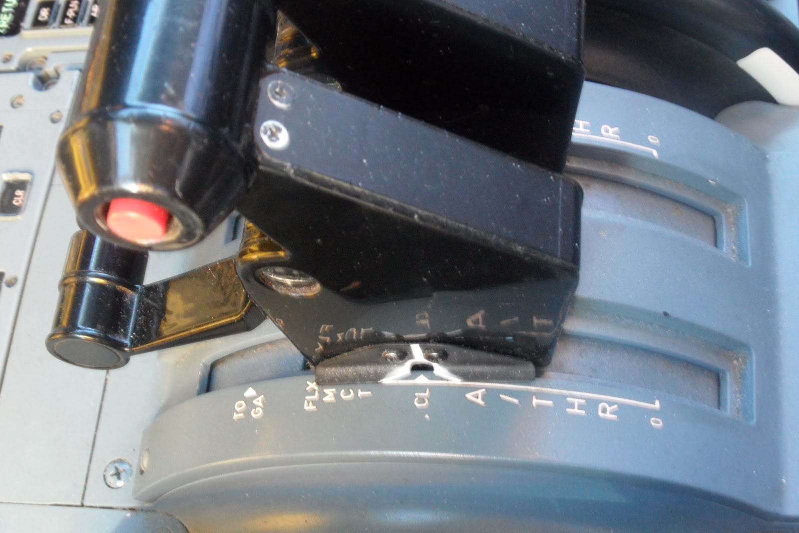

Could someone kindly explain the difference between these (particularly in respect of how an Airbus performs differently in either one, rather than what they 'mean', in theory. THR LVR is clearly a 'lower' detent). Googling hasn't really helped me with this...
Also, after taking off in FLEX mode, should I, when 'LVR CLB' is indicated on the PFD, be pulling back to THR LVR?? I always go to THR CLB (which I think is correct). Talking about X-Plane 11 here, not real-world!

LVR is an abbreviation for "Lever".
The Airbus thrust lever does not have a LVR or "lower" detent. There is a TO/GA detent for Maximum Take Off or Go-Around. There is a FLX/MCT detent for Maximum Continuous Thrust or Flex Take Off and there is a CL detent for Climb Thrust.
Thrust values for CL and FLX are precalculated and stored in the flight management system.
At some point after the take off (I'm sure some people here can tell you exactly when) the thrust levers should be moved from the TO/GA or FLX/MCT detent to the CL detent. The "LVR CLB" indication is a "reminder" for that. When the thrust levers are in the CL detent "THR CLB" for Climb Thrust is indicated on the PFD, as you noticed correctly.

LVR CLB flashes to indicate that the aircraft is above thrust reduction altitude set in the FMGC and the thrust levers have not been retarded to the CLB detent.
THR CLB indicates that the thrust mode is fixed and that the aircraft will use pitch to achieve the selected or managed speed instead of using variable thrust to maintain the selected or managed speed.

The point after the takeoff when you are reminded to pull the thrust levers back to the CL detent is the thrust reduction altitude, typically somewhere between 800 and 1500 feet AAL. The thrust reduction altitude is shown on the Performance-Climb page in the MCDU.

OK, thanks. So CLB LVR is not a 'thrust mode' then, as is CLB THR (if I have understood you correctly), it's just an indication to move the levers down from FLEX or TOGA. My procedure has always been OK, but I was assuming CLB LVR to be a detent (though that didn't make much sense to me - hence the post)... :smile:

The flashing indication is "LVR CLB", (not CLB LVR), indicating you should set climb thrust. The appropriate thrust lever detent detent is "CL".
The thrust mode will change from TOGA/FLX/DRT to THR CLB (or THR DCLB1/2 with a climb derate). The vertical mode will change from SRS to CLB. In this vertical mode, thrust is fixed*, with speed being controlled by pitch.
* If we want to nitpick, thrust isn't quite fixed, as FADEC will adjust for environmental conditions. If you use a derate this will gradually wash out as you climb.
