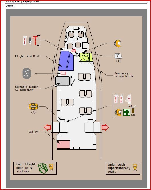

This is the 747-400F upper deck floor plan and the -8f is nearly identical from what I can tell. Ask me again at this time next year and I'll give you a definite answer.
This is the 747-400 BCF floor plan:

by Max Q
Thanks Kaus, but where are the crew bunks on the -400 ?
RE: 747 8F Question
Posted: Mon Dec 05, 2011 9:18 am
by KAUSpilot
The blue shaded areas indicate crew rest in both diagrams; the bunks are stacked on the BCF and head to head on the -400F (there is a wall separating them at the head).
